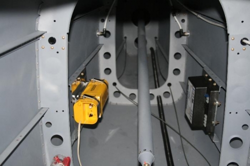

Mounted the power supply for the strobes (2) adjacent to the ELT in the tailcone between the aux and lower longerons.

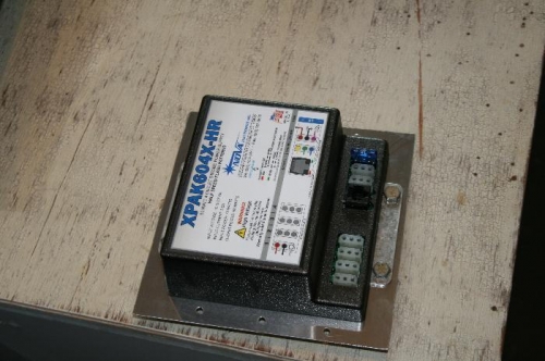

Here's the pwr supply mounted to the base I fabricated

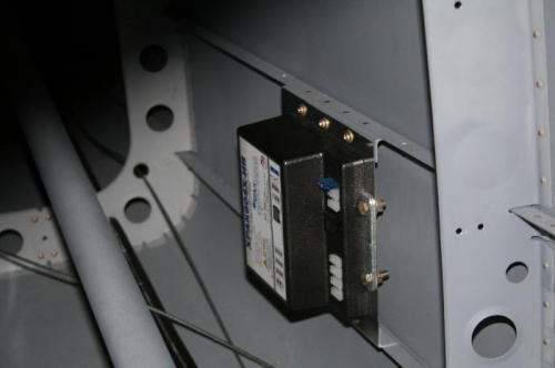

Here it is in place on the left side of the tail cone between the aux and lower longeron
Here's the ELT and the power supply both contributing to a more aft CG -helps balance the Hartzell
