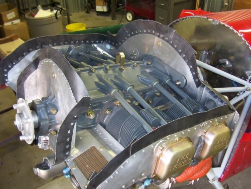

Brief Description:  Baffle seals
Date 9-10-06 Sec 12I installed the baffle seal material with large area pop-rivets and pro-seal. I used patterns cut from thin cardboard to transfer the shape of the baffle to the seal material. After cutting the seal material I transfer the drill locations to the seal. I mixed up some pro-seal and applied it to the baffles. I used clecos and clamps to hold the seal in place. After the pro-seal cured I installed the large area pop-rivets to finish the job. (image) 0449
