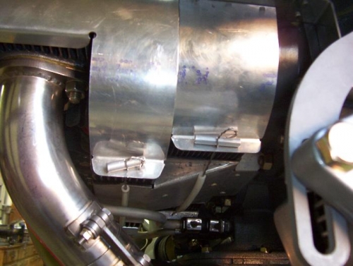

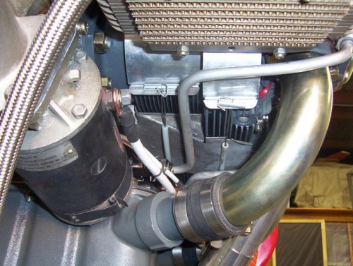

Brief Description:  Inter cylinder baffles
Date 9-1-06 Sec 12I ordered inter-cylinder baffles with all the hardware from Faieth Aircraft .In order to install them I had to remove the starter and the forward cylinder drain lines. The installation was very straight forward .I had to adjust the spring tension on both flat springs and align the baffle to not chafe the oil return lines. I have assembled and riveted together all the components of the baffle system. The last task is to safety wire the lower baffles to rest up-against the lower cooling fins I made ¼” dia. Rods to run the safety wire thru to with strain relief (images) 0447& 0448
