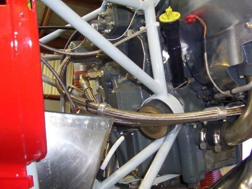

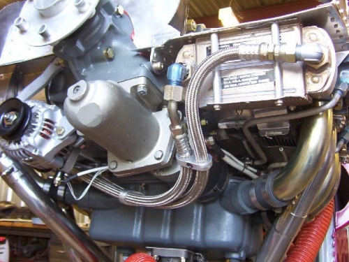

Brief Description:  Oil cooler lines
Date 9-27-06 Sec 12I installed the oil cooler lines under the left cylinders. In order to make it happen I had to come up with some mechanism to hold the lines from chafing on just about everything.I made an aluminum bracket that splits in the middle and is bolted together with a cap screw (image) 0450&0451
