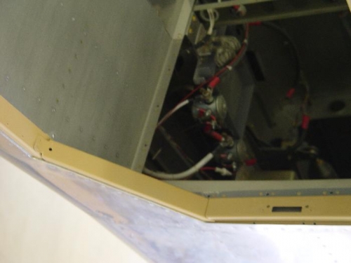

Got small run on baggage door opening - no problem - learned not to try and put an extra coat or shot after making main pass

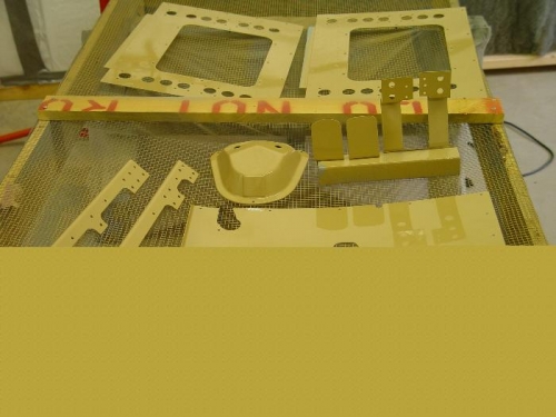

Laid out parts so I could paint them at same time as interior. Things got a little cramped and didn't get all parts evenly but acceptable.

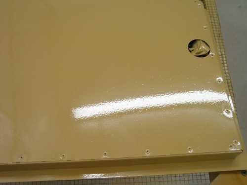

It was very hot and I was soaked in sweat. After I finished spraying, I rushed to get out of the booth and opened the door with the blower still on. A big cloud of (invisiible) dust blew in and covered the baggage door. Lesson learned. Fortunately, the baggage door mainly gets covered with carpet so no damage done.

Baggage door opening
Various removeable interior parts
Baggage door showing dust
