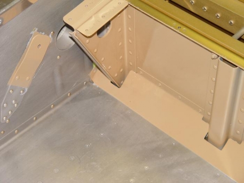

Brief Description:  Interior paint materials and results
Not much paint after a lot of masking but it turned out well. Nice filling properties on the door sill in particular.
Dupont NasonFul-Poxy 491-16 Epoxy Primer - every blemish show thru primer coat
Ful-Thane 2K Urethane - nice filling properties, very glossy
HVLP Accuspray/3M gun 1.1 mm needle - perfect and easy
Door sill - heavy 2 coats

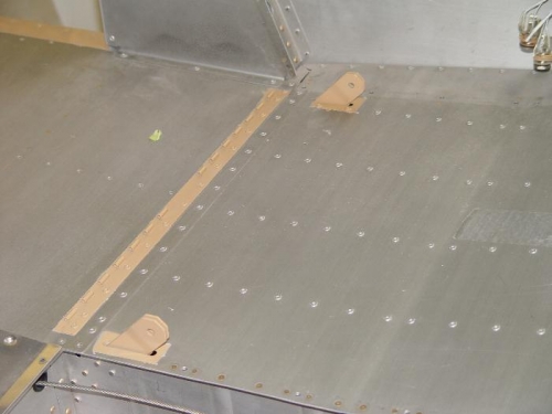

rear seat hinge and seat belt tabs

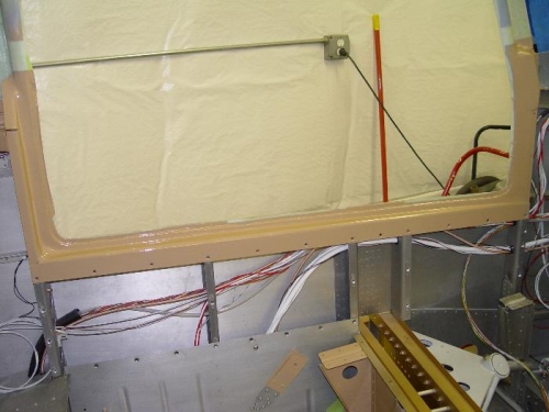

Back of front seats
Back of front seats
