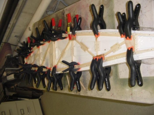

Glued up the first Rib with T-88 . All gussets final fitted glued and clamped in place .
Bought dixie cups and pop cycle sticks for mixing and applying epoxy . Since this is the first set of rib gussets to be glued i had to guess how much to mix . I mixed approx half a cup and threw away about a quarter cup . So next batch will be 1/3 or slightly less. I also coated the whole back of the gusset to help later during waterprofing.
