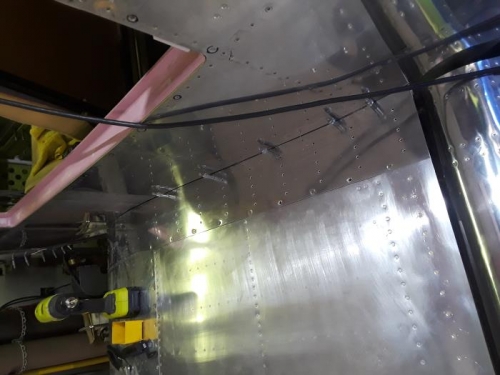

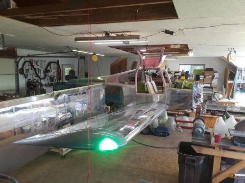

After removing the right wing, the fuselage was turned 180 degrees to provide room and access to the left wing. With the help of my son, the left wing was installed.
The wire connections were completed for Landing light, nav lights, and Archer VOR antenna in the wing tip.
The flap and aileron were installed and connected. The flap required trimming to fit the fuselage.
The fuel tank was connected. A fuel vent line fabricated and installed.
The lower wing root faring fitted and installed with the needed nutplates installed.
The upper wing root faring was completed, fitted and installed.
Left wing is now complete and will be coming back off.
