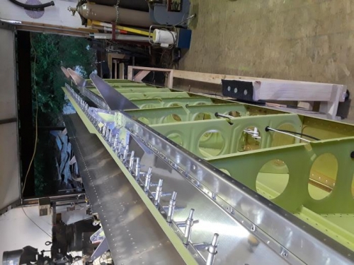

Brief Description:  Flap and Aileron gap renforcement
I installed the flap and aileron gap reinforcement on both wings. A fairly straightforward affair.
I had previously installed the flaps and ailerons and had to remove them to clear the area.
A few more items in the wings and they will be ready to close up. I had previously left the bolts out of the wing tanks thinking I would likely need to remove them somewhere along the way. I finally realized I would not be removing them to paint and had no other reason I could think of, so I installed the bolts. All I can say is that removing a tank from a completed plane will be a major chore.
