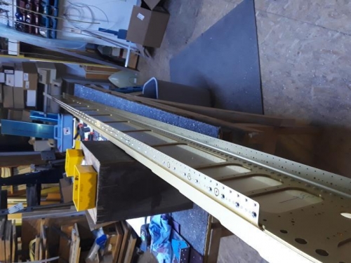

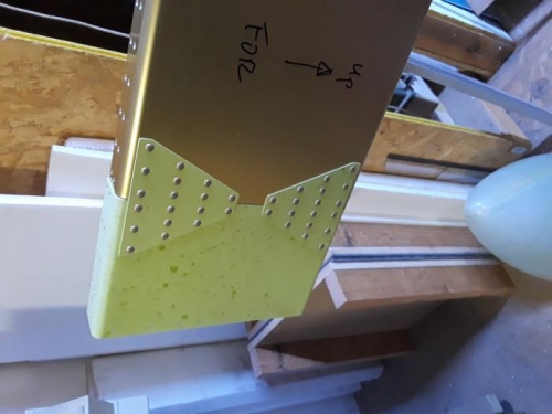

Prep of the wing spars with extensions, countersinking, stiffiners, nut plates, tiedown bracket, and aileron brackets. My arms are sore from all of the drilling.
Both spars are completed including riveting the tie down bracket and priming the flanges where all of the drilling and countersinking has taken place.

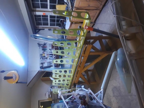

All of the ribs have been fluted to straighten.
Starting the flap bracket preassembly of the ribs
spar extension
spar extension
Left spar almost complete
