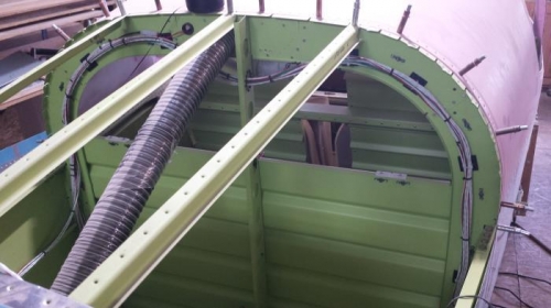

Continuing to work rearward on the wiring

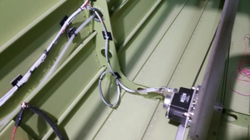

I spliced in the leads from the trim controls to the roll and pitch auto pilot servos.

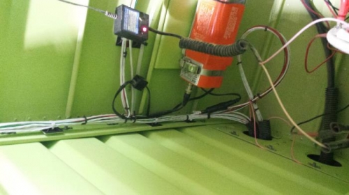

I installed the pitch servo connector and completed the connection as the GSA28 pitch servo is already installed.
I terminated and secured the wiring to the ELT and the connecter for the GMU11.

ELT wiring
ELT wiring
GSA28 wireing finished
Wire route to left side
