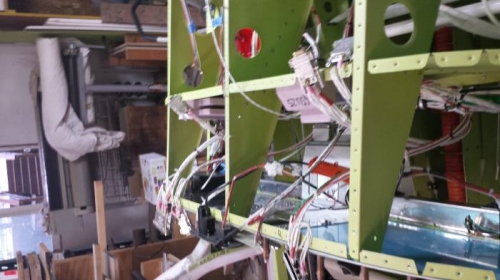

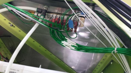

Wire harness forward section is completed. This involved routing and terminating all power leads that tie to the VPX and E Buss, terminating the ground leads, and adding the proper harness supports.
I mounted the GEA 24 and the GAD 29.
Working my way rearward I finished the wiring for the headset jacks and USB outlets. These are all in a package that mounts in the center console and attaches to the center tunnel cover. The center console is now mounted to the tunnel cover. Details next post
ground leads
ground leads
GAD29 and GEA24 in place
