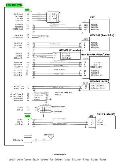

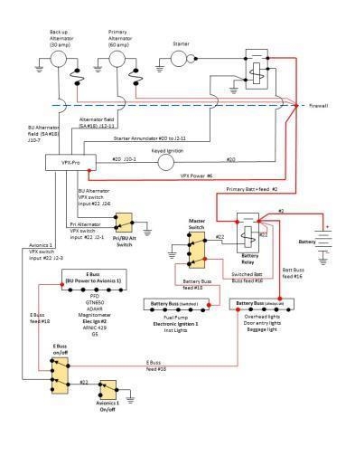

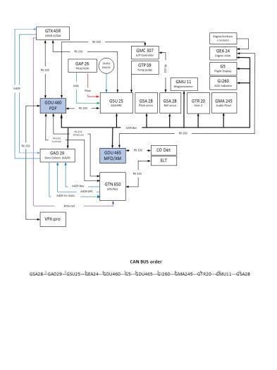

In May I attended the G3X installation class given at the Aircraft Electronics Association (AEA). Three days of intensive, practical instruction on how to put together and wire the avionics in a complex modern aircraft. At the conclusion of the course I sat down to sort out the intended system in my aircraft.
Over the course of the next month and a half I generated 27 pages of detailed electrical wire diagrams. Every wire is illustrated and numbered. Each will be labeled in the aircraft to make tracing easy.
The hours are just an estimate. I likely have twice that into the class, design development and drawings.

main power distribution
communications diagram
typical pin out sheet
