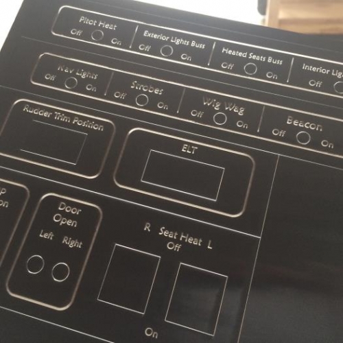

Brief Description:  switch plates
The photo is the first attempt to laser engrave the switch plates. The material is black over clear acrylic. My son uses the laser in his business etching wood and cutting packaging materials.
The text is etched in reverse so the clear thickness faces out. This is called 'second surface' etching and gives a jewelry appearance.
first attempt at laser etching
