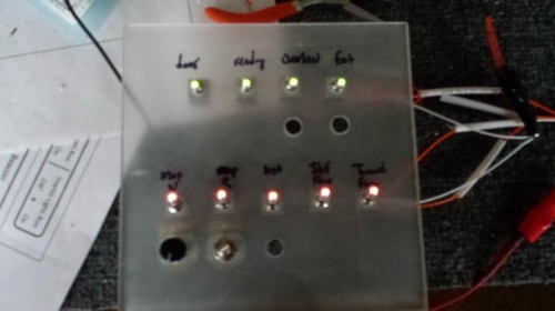

Brief Description:  Switch plate layut

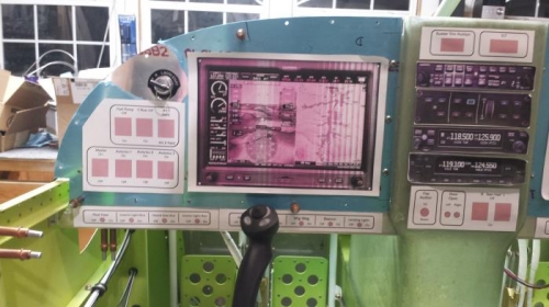

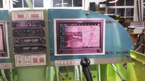

I am planning on mounting all switches to plates to create assemblies that can then be installed into the IP and overhead. Each switch plate assembly will use connectors to allow easy install and removal for maintanance.
The plates will be black on clear engraving stock with all of the graphics engraved to the rear side.
The black will be etched off by laser leaving frosted white lettering that will be backlit. Or so is the plan ...
