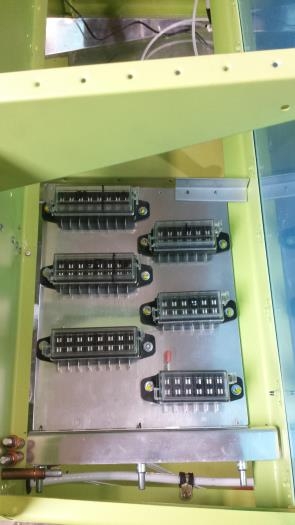

Brief Description:  Working on the VPX configuration
With the weather too cold to cure even bondo without taking it in the house, I am back to working
out the VPX configuration. I discovered I had a significant misunderstanding of the VPX-pro. There are 10 configurable switch imputs. There are 28 power outputs (not 10) that can be assigned to any of the 10 switches creating virtual busses. Each power output can be assigned an amperage value from 2-15 amps depending on the specific pin. The net result is that I only need 3 physical sub-busses. Interior lights, exterior lights, and E buss to cover all of my plans.
Before I figured this all out, I had installed a swing down panel that would have housed all of the individual fuse holders (or sub-busses as I have called them) in one place. Now that comes back out (only held in with clecos at this point) to be slimmed dowm to to the three fuse blocks I need.
Blade fused sub busses
