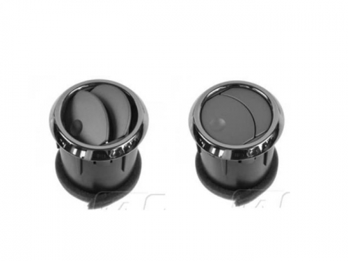

I also am going to try automotive vents rather than eye vents in the overhead fed by intakes rear of the canopy. 2007 Lincoln MKZ Dash Mounted Chrome & Satin HVAC Dash Vent Louver. I'll detail them when they arrive with photos etc. if they work, otherwise they will quietly go away as a bad idea.

Lincon MKX duct covers
