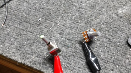

The first pic is of the switches I have chosen. One of my pet peeves is finding unlighted switches in a dark plane at night. The switches have a LED in the tip that will change from red to green when switched (or vise versa). They are wired directly to 12V supply with a 625 ohm resister and a 5K linier pot in series making them dimmable. They are series M2100 ordered from DigiKey.

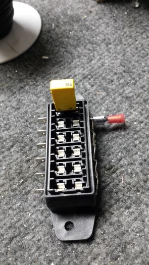

The second pic is of one of the sub-buss/fuse holders that will be used for the powered items that will not have a discrete VPX power pin. By bending over and soldering one side all fuses can be fed with one input from the VPX. This way any VPX output power pin can be sub fused into as many feeds as needed. (ordered from here: http://www.summitracing.com/search/brand/hella/product-line/hella-splash-proof-fuse-blocks?autoview=SKU&ibanner=SREPD5 )
The tall fuse is actually a circut breaked that fits automotive mini fuse holders. ( from here: http://www.digikey.com/product-search/en?FV=fff4000a,fff80043,ffec49af ) series 1620. They remain off as long as the fault remains, but one version resets when th
LED tipped switches
LED tipped switches
blade sub fuse blocks
