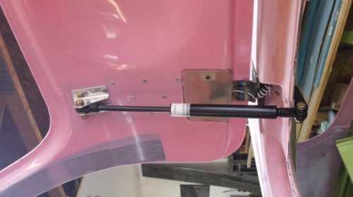

I finished up with the right lift strut by prepping the door brackets, bedding them in flox and riveting them in place.
I used flox to fill the gap under the brackets as they are flat and the surface of the door is concave. I should have left the brackets bolted together for spacing, but figured the match drilled holes would provide alignment. Close but not perfect. I had to ream the holes to get the bolt in. The strut is powerful enough to push the door up any time it is not latched.

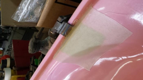

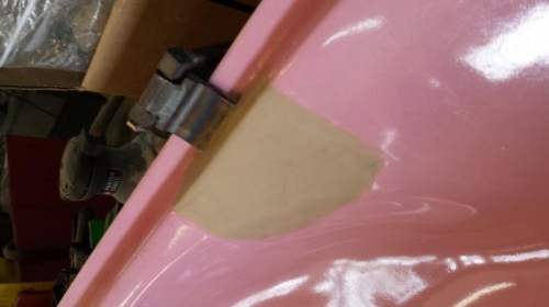

Photos show the lift strut and the process of fabing fiberglass covers for the hinges
lift strut in place
lift strut in place
clay mold ready to lay up glass
glass ready to trim to fit
