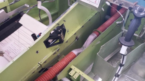

Brief Description:  rework heater duct for interferance

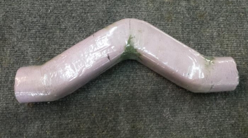

I found out the heater scat tube and the throttle quadrant interfere. The fix there was to cut the section of tube out and fabricate a section of fiberglass duct to go around the quadrant and not interfere with the rudder cables. There is a side benefit in that the section of duct can be easily removed giving access to the fuel lines, filter and boost pump below. (Pulling the entire heater tube was a bugger as the ends are tough to access. In place it blocks 30% of the tunnel opening to access the fuel components)
plug fitted to avoid throttle quadrent
plug ready to glass
plug ready to glass
