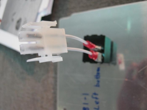

I installed a switch so that I could turn off the stall warning device any time I decide to do prctice maneuvers or light aerobatics. Dont want that blaring noise all the time.

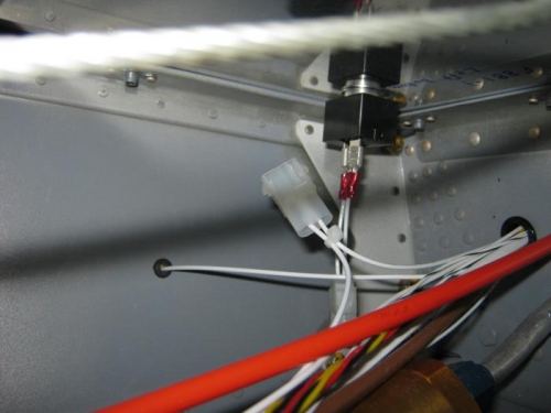

Drill hole in left lower console up out of the way. I picked the left side because the wire from the stall warner in wing comes in from that side.
Installed the switch
Made two short leads and install faston terminals to the switch and then molex pins on other.
Connected the othere half of molex body and pins to other half of circuit.

Stall warner disconect switch and molex  connection
Fuel tank position plate and stall switch installed top view
