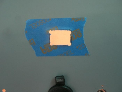

I traced the cutout location then drilled the corners with 9/16 drill for my radius. Followed with dremel and cut out the opening. This was then finished off with filing and sanding and polishing as required for fit.
2 mounting holes were then match drilled to #30.

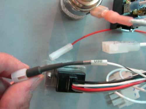

Connections under the console are similar to how I did the wig wag and 12 v adapter plug except I tried the molex mini connector. The wire was also labled as usb on both ends. The ground wire was grounded locally at the flasher unit attach screw with other grounds.

Cut rough opening for USP port
Molex mini connection for usb

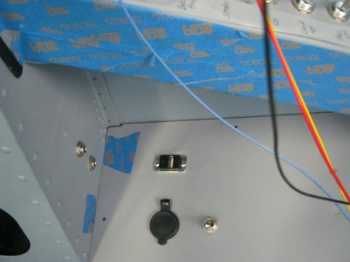

Console in place with the USB port, 12 volt plug, and wig wag
