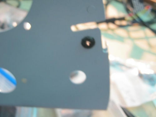

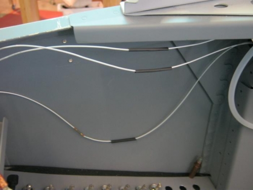

Left side eyeball light wire was cut and pin for dsub and shrink tube. I wont shrink the tube however untill after I install the panel apron for good. I drilled the hole on each side to 1/4 inch and installed rubber grommets. Now i can run the wires thru the panel sides out of sight and then connect them. The right side has three wires. 2 for the stereo input and 1 power wire for the two map lights.
rt side grommeted hole for wire pass thru
the stereo input and map light power wires pinned
