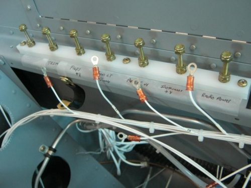

Brief Description:  terminal block final install and grounding studs t
1. I had recieved my harware called for in the plans from acs so I removed the 7 post terminal block and installed the seven screw studs and secured with lock nuts. The wires were loosely atached to the points called out. Theese studs are intended to distribute the power from the switch breakers in the control console. There are 2 spare posts and plenty of room of additional add ons.

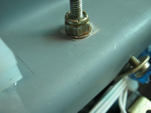

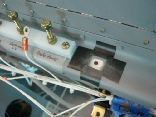

2. There is a grounding post on each side of the terminal block and secured directly to the brace. I masked of an area about each point and sanded off the paint for a good ground. the studs are secured with a star lock washer on top and bottom of the brace. The teeth of the washers will help provide good ground by biting into the metal.
terminal block with proper 1 1/4
terminal block with proper 1 1/4" hardware installed
ground stud points masked and sanded free of paint
7/8
7/8" ground stud screw with lock washers installed
