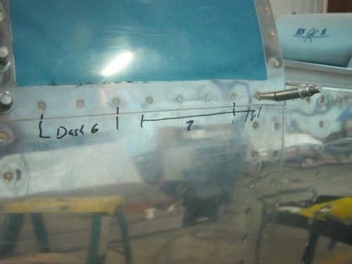

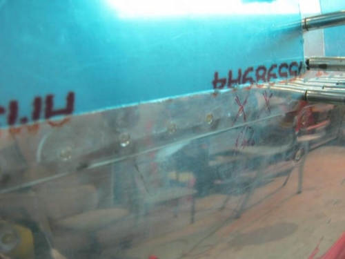

Let me explain these rivits some along the longeron. The plans call for dash 6 length rivits all along the row except one dash 8 center bulk head. I had a problem with this. Dash 6 works well for only thre spots just before the gear tower. The 4 before those have an extra doubler and the dash six wont comporess to the proper head hight and diameter im told we need. Infact they almost compress flush with the metal sheet! So, I thought dash 7 would be better. All I have are dash 8 and cut the ones I needed to 7. These work ok but will easily fold fir some reason. I have two on the right side that I need to drill out and redo. Dash 6.5 might be better choice here. Just a heads up to anyone reading this.

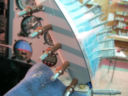

The other time eater here was that the dimples were not good enough for the rivits to sit flush. Probably due to my attempts to bend the skin edge for a tight fit or something. I dont know. Anyway, I used the cutter and microstop for all these rivits on both sides and
Left side longeron to top fwd skin rivits set
right side longeron to skin rivits set
