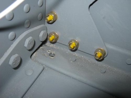

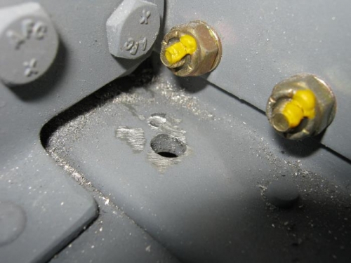

Brief Description:  File interfearing rivit down on left outboard wear
One problem on gear leg hardwar attachment is the outboard left forward bolt hole. There is a rivit protrusion that interfears with my washer placement. A call to Vans previously told me that the two outermost holes on wear pale were more for just aligning and holding the wearplate on than for structural stength in the gear leg attachment since it only goes thru the aluminum angle and no steel. Was told I could notch the washer to fit around the rivit or just file it down and rest washer over it. That is what I did.
