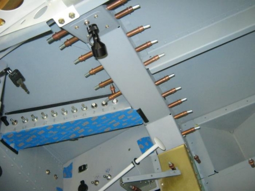

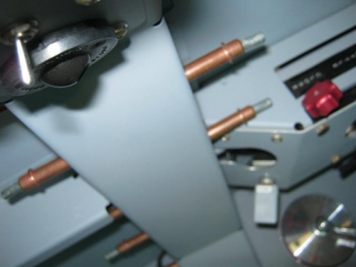

Went to rivit on the left and right center bulkhead covers and ran into a problem. I only have 37 LP4-3 rivits and I need nearly 90! not suprised thpugh. I clecoed on the right side
Spray painted the rivits that I have with two coats

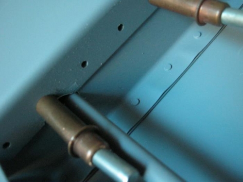

Rivited on the left side and ran into problem no two I didnt relieve the area on the cover lip where than rear throttle holes were made into the bulk head. So.... I had to remove the cover and grind the relief area with dremmel and grinding stone and then clean up edges. Big pain!
Its ready for rivits now so ILL use what I have and order more
RT side bulk head clecoed

Left side bulk cover showing problem with rear throttle tube
Guess the throttle box will need to come out inorder to rivit the cover on
