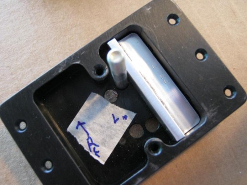

4. Cut an insert for the cavity in the bracket so that the bulkhead wont deform in to the bracket when the bolts are tightened. Did a trial piece and bolted in place to check how well it works.
5. Drilled and rivited the insert to the bracket cavity. Since the bracket will be rivited in place, upon removing the bolts that will secure the valve to backet, I dont want the insert to move.

Piece of alum angle inserted and later rivited in place. Nothe the bolt showing the mounting holes to

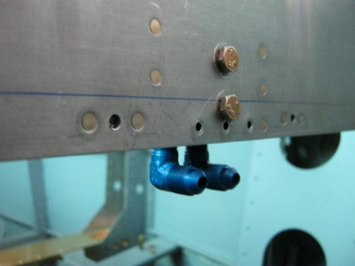

Baggabe side view with bolts. Note the center bottom rivit hole.

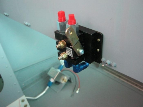

Valve temp bolted in place.
