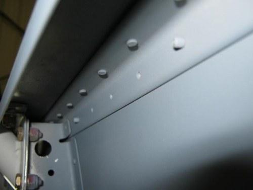

1. Decided to reroute the static line under the top rail all the way to the panel. This required me to drill four 1/2 inch holes along the way. I dont have 1/2 inch snap bushings so Ill order some before I put the line thru.

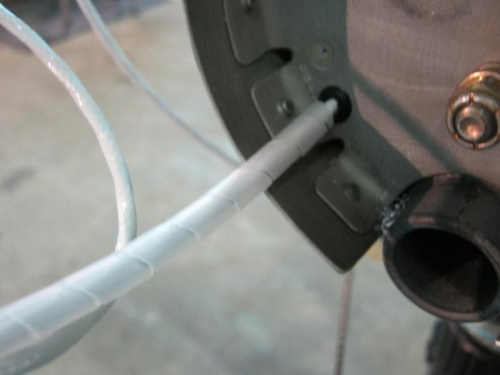

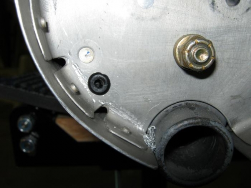

2. Next was the reroute of the tail light/strobe multi conductor shielded wire through the bottom portion of the aft most tail bulkheads. I drilled 15/64 holes in the bulkheads and installed a rubber gromet in each bulkhead. Inserted the wire and put some wire wrap on for protection. The remaining route will be in some conduit when I get some. I also need to run the trim tab wires and branch in to this wire run.
Small rubber grommet from local automotive store. 1/8
Small rubber grommet from local automotive store. 1/8" I.D gives snug fit on wire
Tail wire exit and wrap
New holes drilled to 1/2 inch for the static lie
