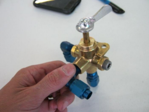

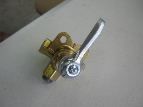

1. Filed off the pointer on fuel valve lever per instruction. The lever will act as the tank position idicator.
2.Made 2 spacers and cleaned edges etc.
3. Install the fittings called for in the fuel vale.
4. Drilled the holes in fuselage bulkead to 7/16 and installed the 45 degreee elbow bulkheaed fuel line fittings.

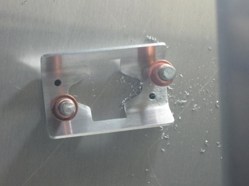

5. Cleaned up the edges of 1 of two airflow brackets and then clecoed to the left side flor board and drilled the 4 holes to #30
Pointer filed off fuel selector lever
AN fittings installed and adjusted to proper positions
Airflow bracket cleaned up, clecoed to floor, drilled to #30
