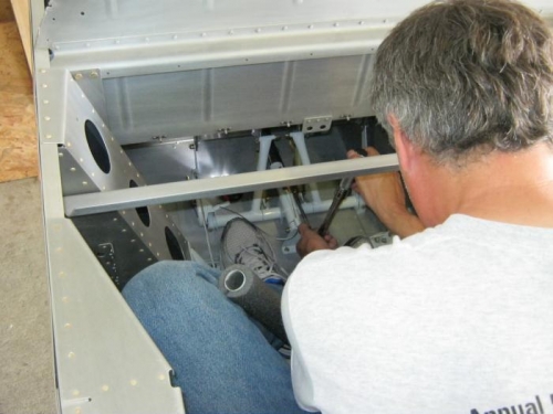

3. Instaled the front brake/rudder pedal assembly to the front cockpit floor and firewall.

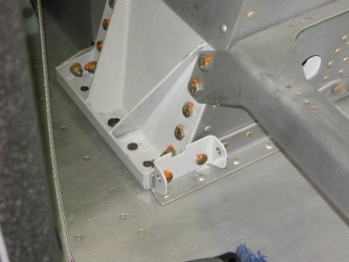

4. Installing the idler brackets for the rear seat pedals by first removing two bolts at aft side bottom of gear towers, positioning the bracket where the bolts were and then marking the hole location on rear side of brack with a shrt drill bit. Remove bracket and drill and deburr. check for fit. bevel bottom edge to fit in radius of the angle and bolt in place with slightly longer bolt. Note: the nut and washer is a royal P.I.T.A! to reach and then tighten. Took awhile to do.

Sitting my aeroplane bolting in the rudder pedal assembly. Didnt I make a rotisserie?

Idler bracket installed. Note the torque seal on weldment bolts? see note above
