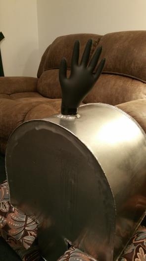

Fuel Cell Pressure Testing
We chased a couple of pinhole leaks on the tank using a very low applied pressure and soapy water. Got them all closed up and pressure tested overnight. Everything is all welded up and ready to seal.
