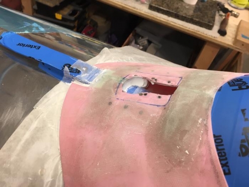

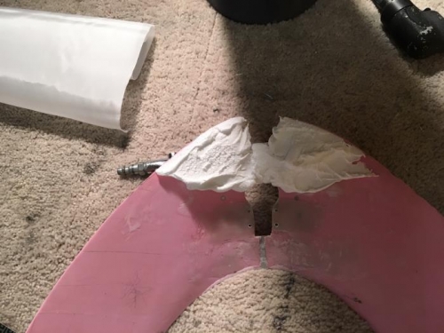

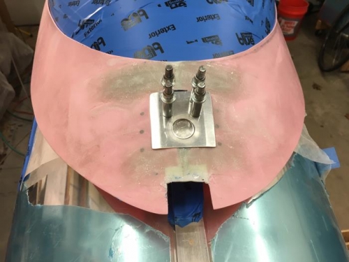

Today, I pulled the dacron from yesterday’s session. I re-drilled the holes from the push/pull to the skirt and then pulled the skirt off and sanded the newly laid glass smooth. I put some wax paper on the fuselage to protect against the flox. I mixed up a non-structural flox and spread it on the underside of the aft canopy skirt. I re-installed the skirt, and closed the canopy so that the skirt and the flox would form fit to the fuselage. I pressed the skirt down on the fuselage and cleaned up the flox that squeezed out. Now to let it dry…
push/pull - v3.0, I believe
underside of the aft skirt
squeezed out and drying
