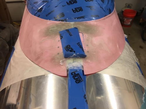

Gap fill and rivet hole fill
Today, I filled in the gap at the middle of the aft canopy skirt and since I am seeing the rivet holes wallow out a bit – I decided to fill in the holes with the structural epoxy and then re-drill the holes for the push pull.

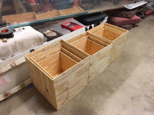

I have also been working on "other projects"
dance studio boxes - almost done
