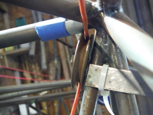

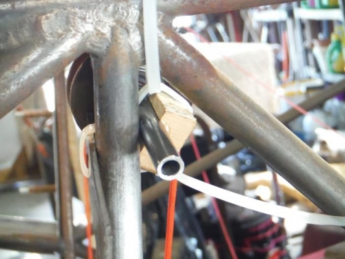

Drilled and reamed 3/8" x .065 x 2" bushings to 0.250".
Installing the rear flap pulleys turned out to be an extreme excercise in patience. I fought with C-clamps for quite some time, trying to correctly position the bushing for welding. I finally gave up on the c-clamps and vise grip clamps and resorted to my trusty tie-wraps. Took a few minutes but got it to where I could tack the bushing.
Both rear flap pulleys tacked in position.
