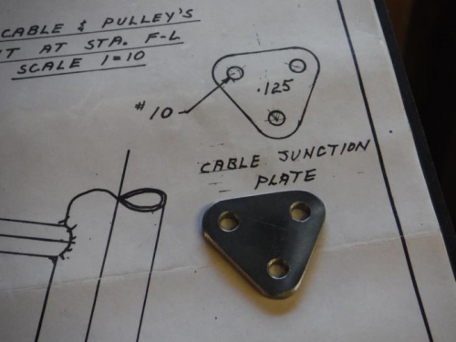

Started on install of flap cable pulleys and fairleads.
Made flap cable junction plate out of 0.125 4130.
Drilled 3/16" hole in flap lever for shackle to run cord to position pulleys and fairleads.
