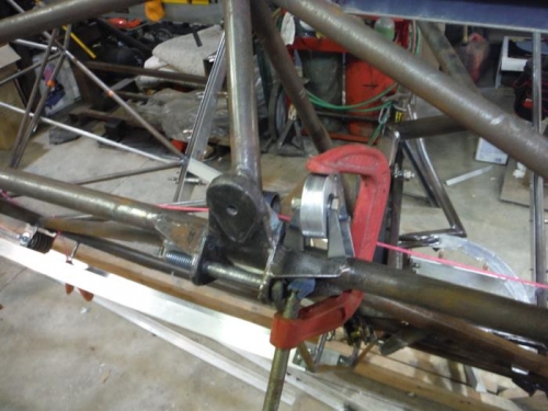

Brief Description:  Tacked Aileron pulley brackets in position

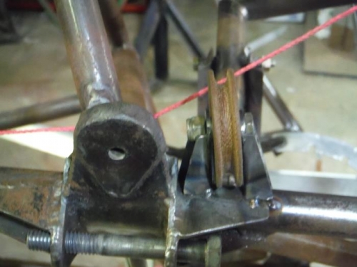

Made second set of aileron pulley brackets.

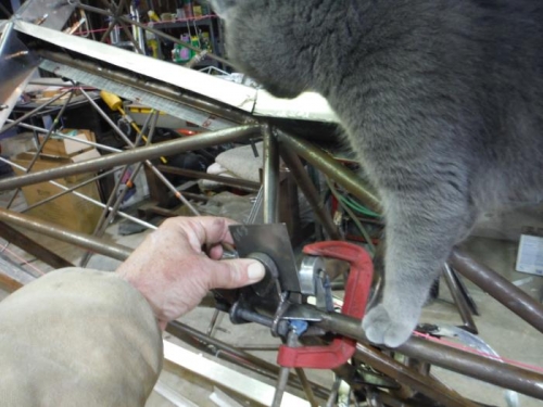

Difficult part to position and jig. Got lucky and had a 1/2" aluminum cut out from a hole saw. Almost exactly inside diameter of pulley. Could use for positioning and then weld. Both brackets only tacked in position. Will check for correct position when strut installed. Then final weld.
