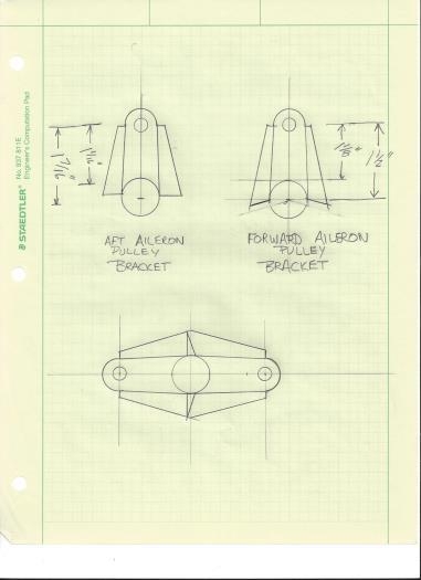

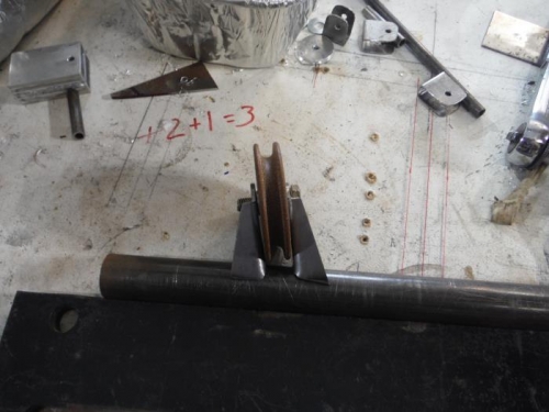

Brief Description:  Start on Fuselage Aileron Pulley Brackets
Making aileron pulley brackets that are welded to the lower longeron just ahead of the wing strut attach bracket.
3/3/16 ADDENDUM- After installing struts and checking control cable alignment, determined that the aileron brackets on the left side needed to be longer than the right. Can only attirbute this to small differences of position of the lower spar attach fitting. See post dated 3/2, 3/3, 3/4.
