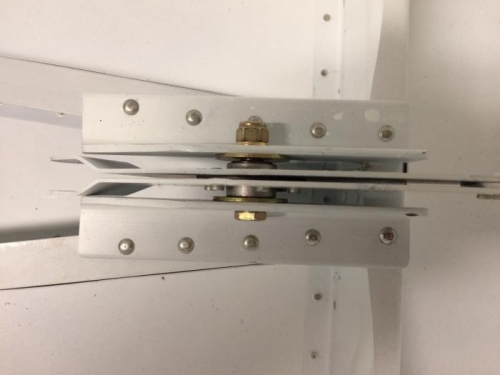

Today I drilled the elevator bellcrank up to size, as it was just piloted. Took it apart, deburred, and rveted the brackets back on. I put the hardware back in, but I need to go to the next longer bolt. There are no threads sticking out past the locknut.

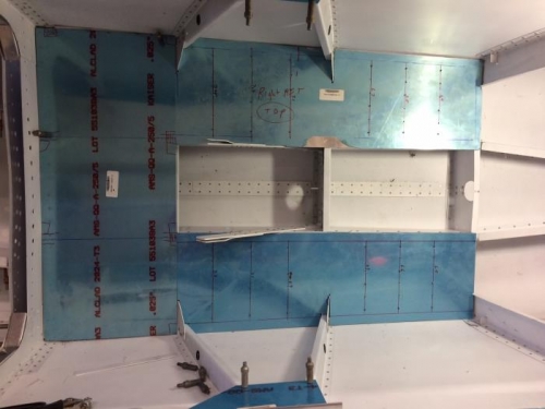

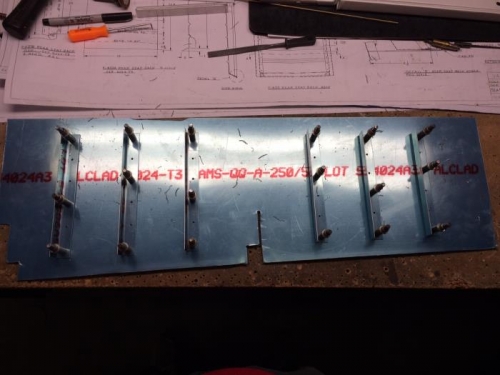

I then spent quite a while fitting floorboards. After I was happy with their fit, (lots of shavings from vixen file) I located and drilled the stiffeners to the bottom of the rear outboard panels.
I have to say it looks pretty cool to have the floor going on. I'll be sitting in this thing soon!
Riveted Elevator Bellcrank.
Drilling stiffeners to floorboards.
Fitting floorboards.
