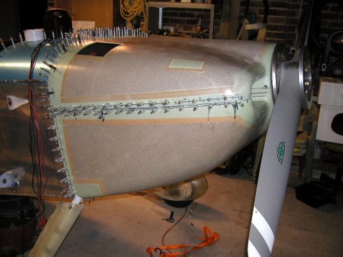

I have been plugging away at the cowl for the last week spending about 1.5 to 2 hours each night to get the fit to a reasonable standard.
Tonight I finally installed and back drilled the horizontal hinges, which I am goingto install from the cockpit forwards so that there is no need for an external retainer.
Right side view, ignore all the black pen markes which make it look like the clecoes are diverging
