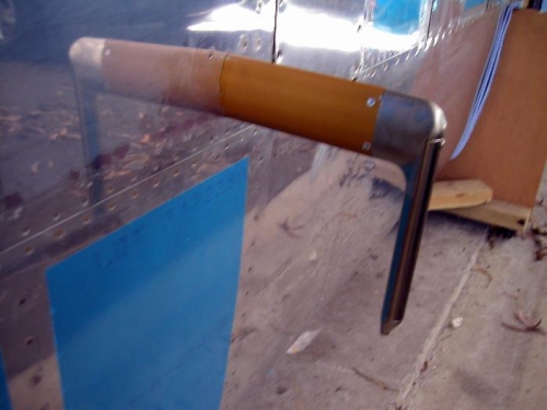

Got back from a 1 week flying holiday in Wilpena Pound on Saturday, and after a good sleep in decided that Sunday afternoon would be a good time to cut the hole for the Pitot mast.
With this done I removed the required rivets from the wing skin/spar (6 all together) to allow the mast to be located and riveted into place.
The original Pitot hole will be filled with that two part metal filler stuff, can't remember what its called at the moment.

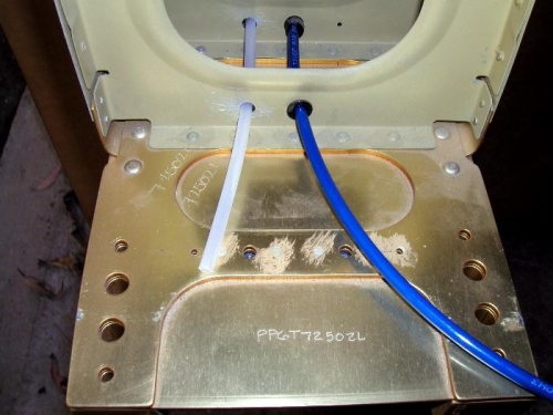

The blue line is connected to the Pitot and the white line is the angle of attack.
Hole in skin cut, pitot and mast installed adn riveted

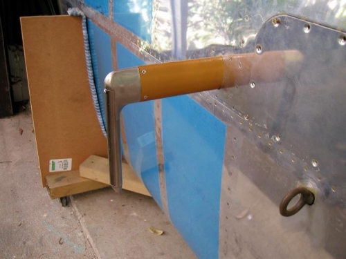

Another view
The blue line is the pitot, the white line is angle of attack
