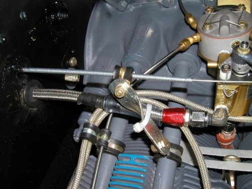

Brief Description: Fuel Purge valve fuel line installation
In the first shot you can see the fuel line connected to the purge valve and also the control cable to select the run and bypass modes for the purge valve.
In bypass mode cool fuel is drawn from one tank and circulated through the fuel injection servo and up to the purge valve where it is sent back to the opposite fuel tank.
I have almost completed the pluming for the fuel T that allows me to return the fuel to the right tank.
In by-pass operation mode cool fuel will be drawn from the Left tank circulated throught the system and then returned to the Right tank.

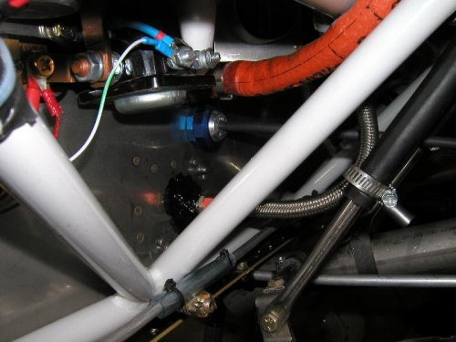

I used the spot that was meant to hold the fuel pump for non-injected engines as the point to penetrate the firewall as it already had a couple of nut plates that I could use to clamp the connector into place
Line connected to fuel purge selector
Firewall penetration, bottom braded cable

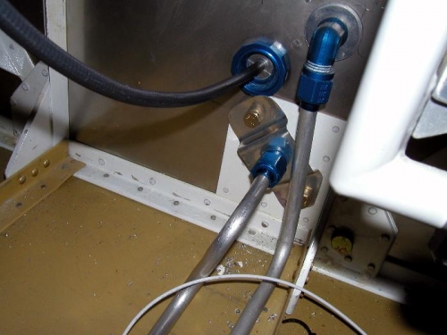

Cabin side view, the bottom aluminium line is the return line
