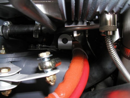

Installing these parts was a little painful, its really tight around the engine sump, intake tubes etc. so installing anything here is very frustrating especially with big hands.
Both the throttle and mixture assemblies required that I make up a spacer to relive the angle of the cables / push rods, not a big deal but also not in the instructions, so I guess my sump layout is slightly different. (see image 1 for example)
Its done so another job out of the way, there seems to be an incomprehensible amount of stuff to install on the engine, I must be getting near to the end and then its onto the cowl and baffling....
Throttle bracket in the background (white) and the throttle arm, spacer and mounting rod

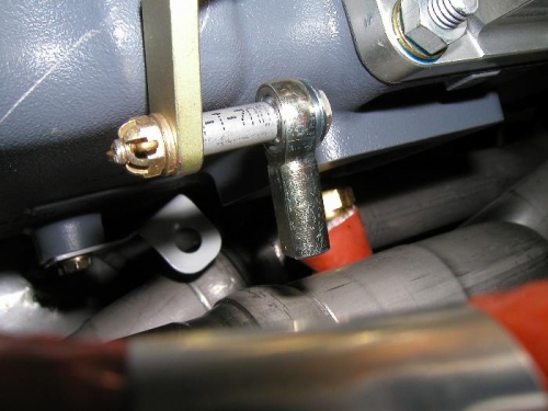

Mixture bracket in the rear (white) and control linkage

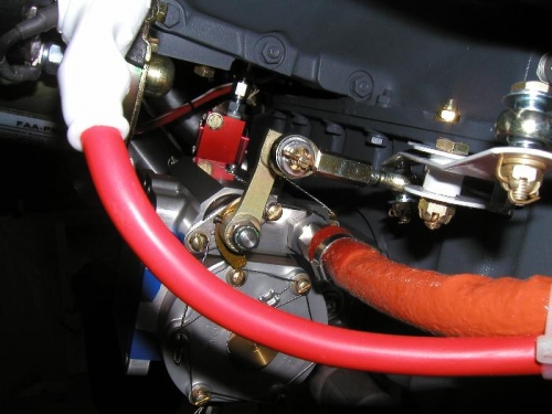

More mixture bracket linkage
