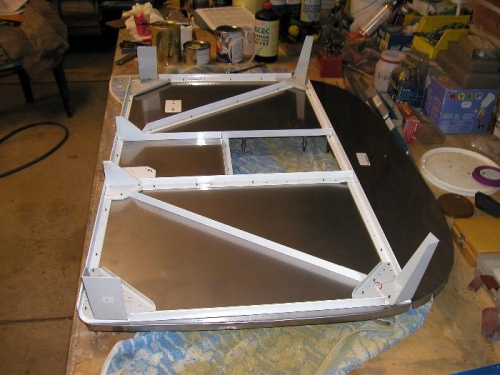

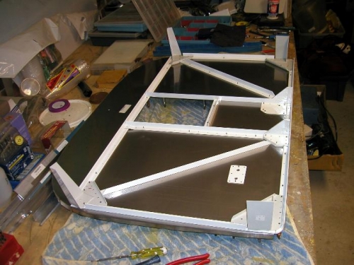

Brief Description:  Painted firewall stiffeners gloss white
After the etch priming had dried, I gave the stiffeners a coat of 2 pack gloss white. The paint is really easy to spray, but I need to thin it down more next time. I am also still getting used to the HVLP touch up gun that I bought, and I have not gotten my head around how little paint it uses compared to the normal siphon feed touch up gun that I have been using. So the reason for stating all of this???
I mixed up way too much paint, 60% too much to be exact, leason learn for next time.
If the paint hardens enough (quite cold here, it's the middle of winter) I will probably try to rivet the stiffeners tomorrow night.
