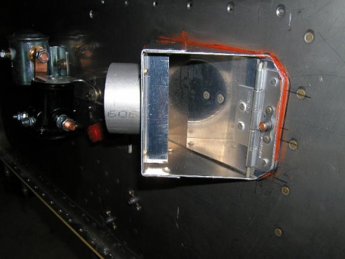

Brief Description:  Heat selecter box
I ended up cutting a rectangular hole as I don't have anything other than an angle grinder that will cut stainless steel, so I marked out the location, drilled 4 holes, one in each corner of the rectangle and then did the cuts, it came out pretty good after a little cleaning up of sharp edges with a file, then it was a matter of locating the heater selecter over the hole, back drilling, appling silastic and bolting into place.
Flapper installed on firewall
Lots of high temperature RTV to seal the hole
Another view
