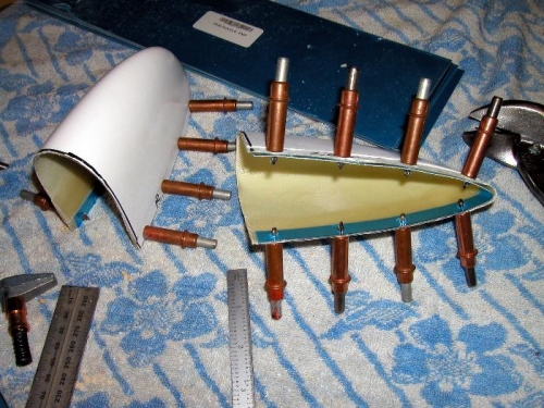

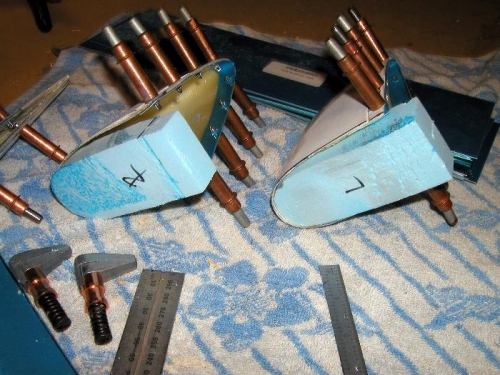

Feeling like I was on a roll, I also drilled and glued the other fiberglass parts except for the bottom of the rudder. Next step is to glue the foam block into place and then fill and sand to give a good transition before riveting all the tips into place...
Aluminium strips back drilled to the tips
Foam blocks to fill the ends of the horizontal tips

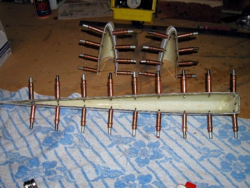

Waiting for the glue to set
