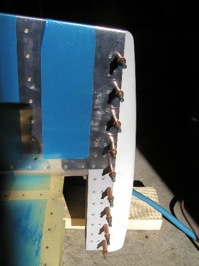

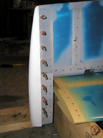

Its been a while since I have put any real effort into making progress, one its winter and its very cold out in the garage, tow the Olympics are a distraction, but today was a beautiful day with temps in at 15 degrees so I decided that I had put off fitting the fibreglass tips long enough. I cut and installed some aluminium strips inside each elevator tip using 5 minute araldite and once this had set, cut and trimmed the fibreglass and the lead counter balance weight to get a good fit, the left side went well but the right side tip cracked as I tried to flex it into place, it will require some filled and then need to be sanded back.
Left elevator witth tips fitted and abck drilled
Right elevator with tip fitted and back drilled
