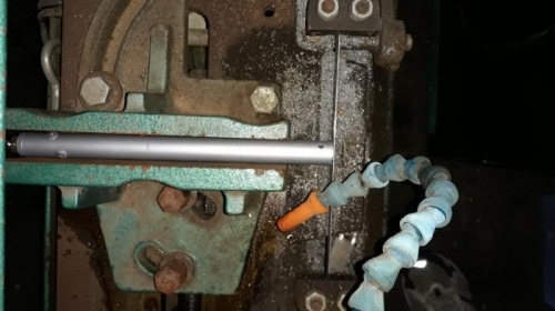

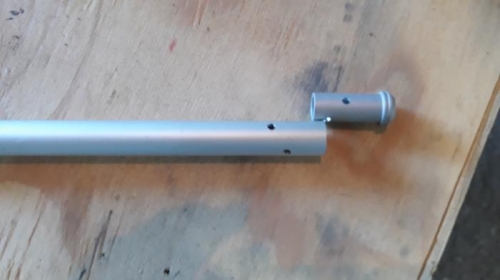

Brief Description:  1 - shortened steering push rod tubes
I drilled out the four rivets that hold the end caps on one end of the push rod, measured 20mm from that end and then cut & deburred the tubes. I inserted the end cap on the tube and temporarily installed the push rod to test the fit. Looks good.
drilled out end cap rivets
measured and cut tubes
test fit looks good
test fit looks good
