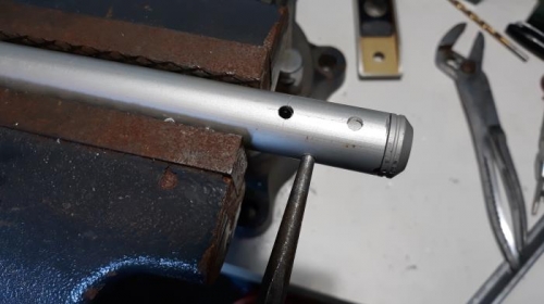

After measuring, marking and drilling one of each hole in the pipe, I located one hole with a puch and and match drilled the other hole through the other side. I then deburred the holes and riveted the assembly with 5/32 x 3/16 sst rivets.

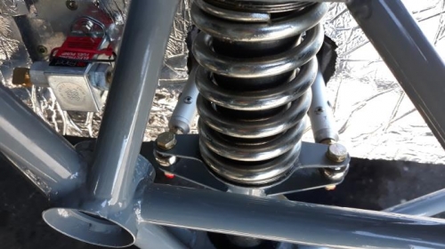

Finally I installed the pushrods and roughly adjusted the steering / rudder positions. There is a bit of friction in the system and the extension springs are not quite strong enough (or stretched enough) to overcome this. I'll work on that next time.
match drilling end cap holes

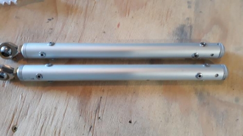

push rods completed
push rods completed
steering push rods installed
