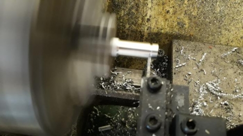

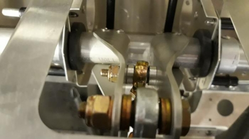

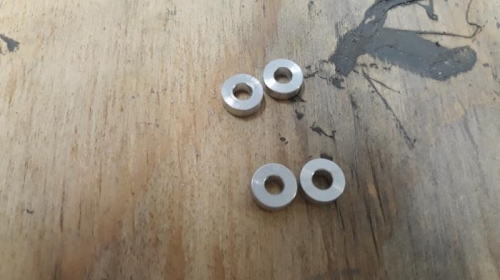

Installing two washers on either side of the swivel eyebolts is a pain, and in the case of the Garmin pushrod kit, the eyebolt is narrower than the TAF version. So I made two sets of 4mm (5/32") thick spacers, 7/16" diameter and installed them on both servo pushrods where they connect to the control inputs. Much easier to install, and now the right thickness.
I also set the length of the elevatar pushrods and tightened the locknuts.
turned, drilled and parted spacers
debur and measure
debur and measure
installed new spacers
